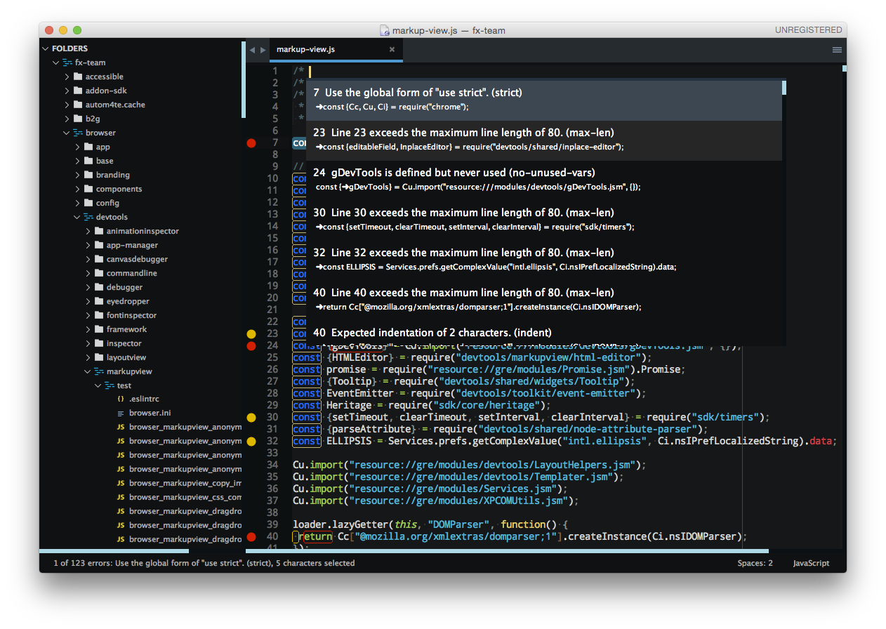

Once done, open the mozilla project in SublimeText and open any JS file in the /devtools directory. You can then trigger the linter via the contextual menu (right click on the file itself) or with a keyboard shortcut (ctrl+option+L on Mac).
You should see errors and warnings in the gutter as shown in the screenshot below. You can also see all errors listed with ctrl+option+A, and individual errors by clicking in the gutter marker.
ESLint in SublimeText 3

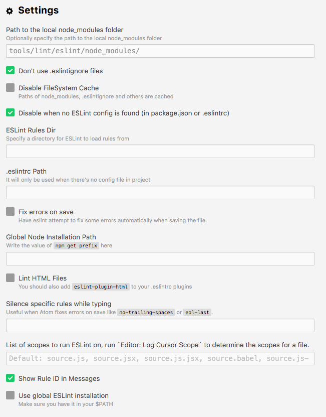

Install the linter-eslint package v.8.00 or above. Then go to the package settings and enable the following options:
linter-eslint settings in Atom
Once done, you should see errors and warnings as shown in the screenshot below.

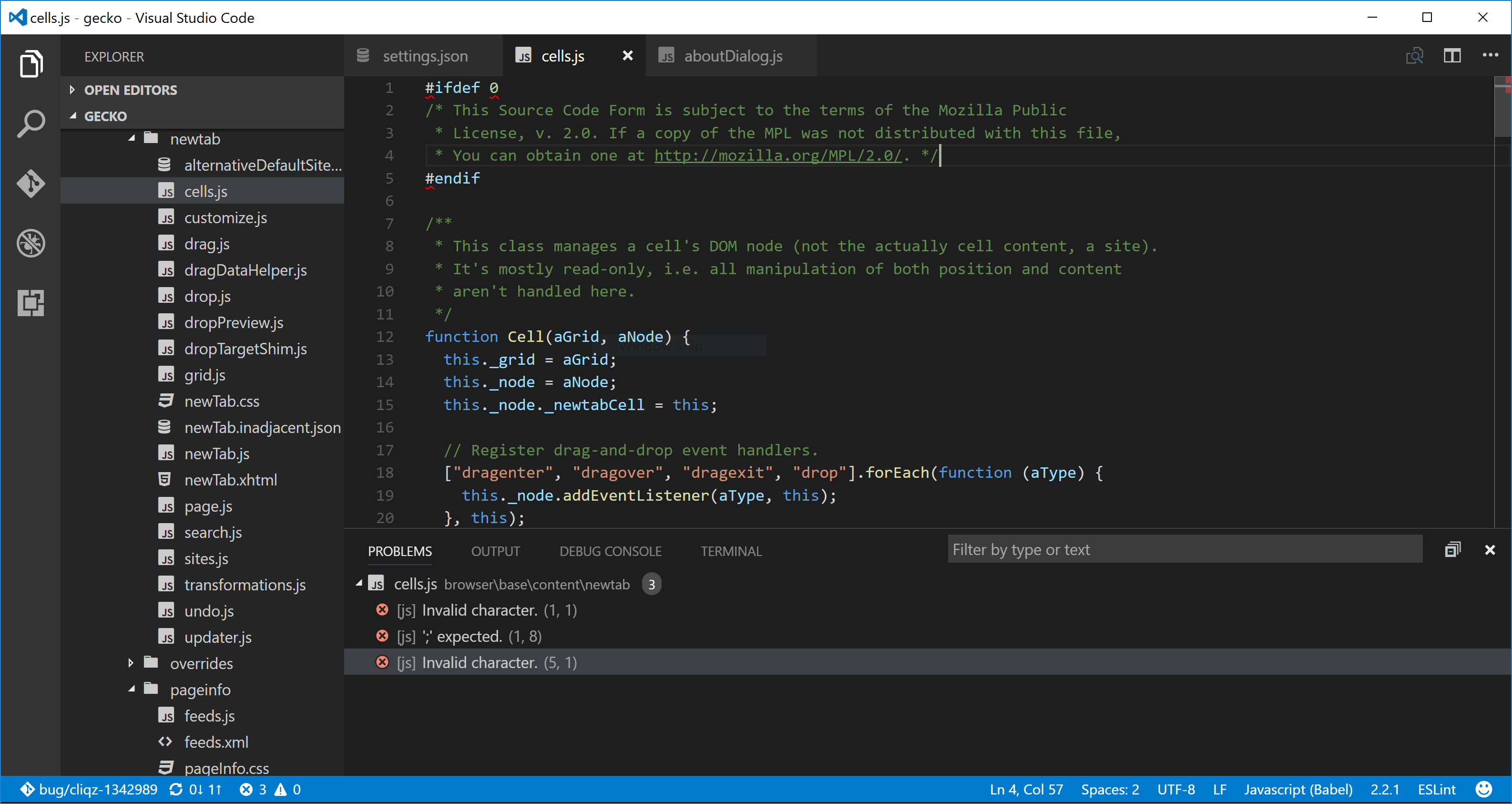

Once done, you should see errors and warnings as shown in the screenshot below:
ESLint in VS Code
